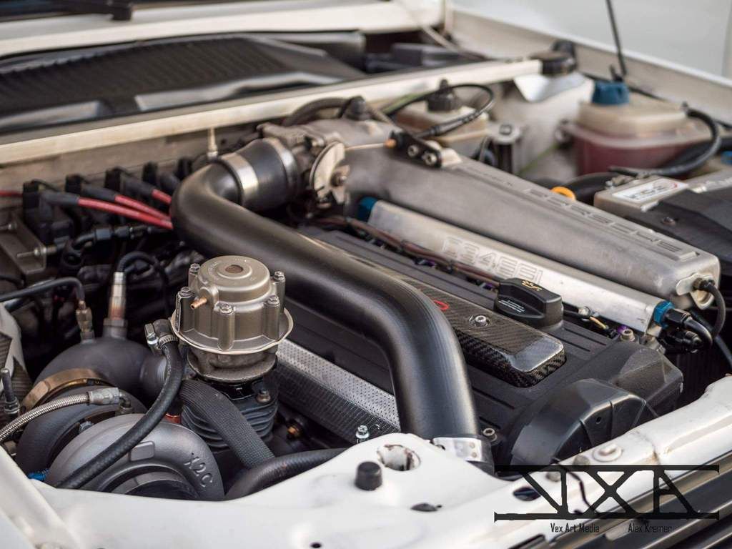

Engine
- 3B from my old '91 200
- AFE Cone Filter
- Xona Rotor 5456 A/R .63 Turbo with V-band turbine outlet Ceramic Coated
- Intake Plumbing Powdercoated Texture Black
- PWR Intercooler coated with Thermal Dispersant
- Forge BOV
- Custom Ported Throttle Body
- 034 Billet Throttle Cam
- RS2 Intake Manifold
- 1000cc Injector Dynamics Injectors
- 034 Iic Standalone with e85 and 91 oct tunes
- 034 Fuel Rail
- Fuelab Adjustable FPR
- Fuel Pressure Gauge
- 034 Phenolic Intake Spacer
- Rebuilt Head with New Valves, Seats, and Seals
- HD valve springs
- Powdercoated Textured Black Valve Cover
- Carbon Fiber Spark Plug Wire Cover
- HO Coils with 034 Coil Mount
- ARP Head Studs
- Venolia Pistons
- Total Seal Rings
- Scat Rods
- Coated bearings (Rod and Main)
- Completely Balanced Rotating Assembly by Repaair
- UrS4 Windage Tray
- Sport Quattro Exhaust Manifold Ceramic Coated
- Iroz 3" SS Downpipe Ceramic Coated
- 034 3" SS Exhaust with Flowmaster Muffler
- Fidanza Aluminum Flywheel
- ARP Flywheel Bolts
- South Bend Stage 5 Extreme Clutch
- Ron Davis Aluminum Radiator
- 80 C Thermostat
- Vortex Breather Separator
- 034 Catch Can
- 4kq Alternator
- 034 Motorsport Motor Mounts
- Optima Yellow Top Mounted in Trunk
- Ingersoll Rand Boost Control Valve

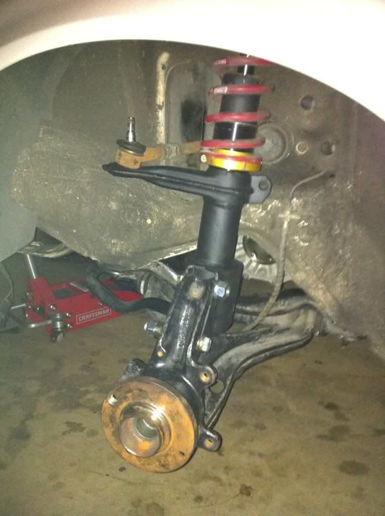

Suspension
- Toyota MR2 Electric Steering Pump
- B4/90 Front 2-piece Strut Housings
- B3/90 Front Lower Ball Joints
- H&R Camber Bolts
- Koni Adjustable Front Strut Inserts
- A-1 Racing Coilover Sleeve in Front
- Eibach 300 lbs Springs (Front & Rear)
- Ground Control Coilovers rear
- 2Bennett Front Adjustable Upper Strut Mounts
- B4/90 Front Upper Strut Brace
- 034 Track Density Rear Upper Strut Mounts
- Bilstein Sport Rear Strut Inserts
- 4kq Front Anti-Sway Bar Mounted in the Rear
- Blau Sport Control Arm Bushings
- 034 Front Offset Solid Subframe Bushings
- 034 Rear Solid Suframe Bushings
- 034 Front Anti-Sway Bar Bushings
- Corner Balanced and Aligned by Taylor Chapman
- 15mm H&R Trak+ Spacers in Rear

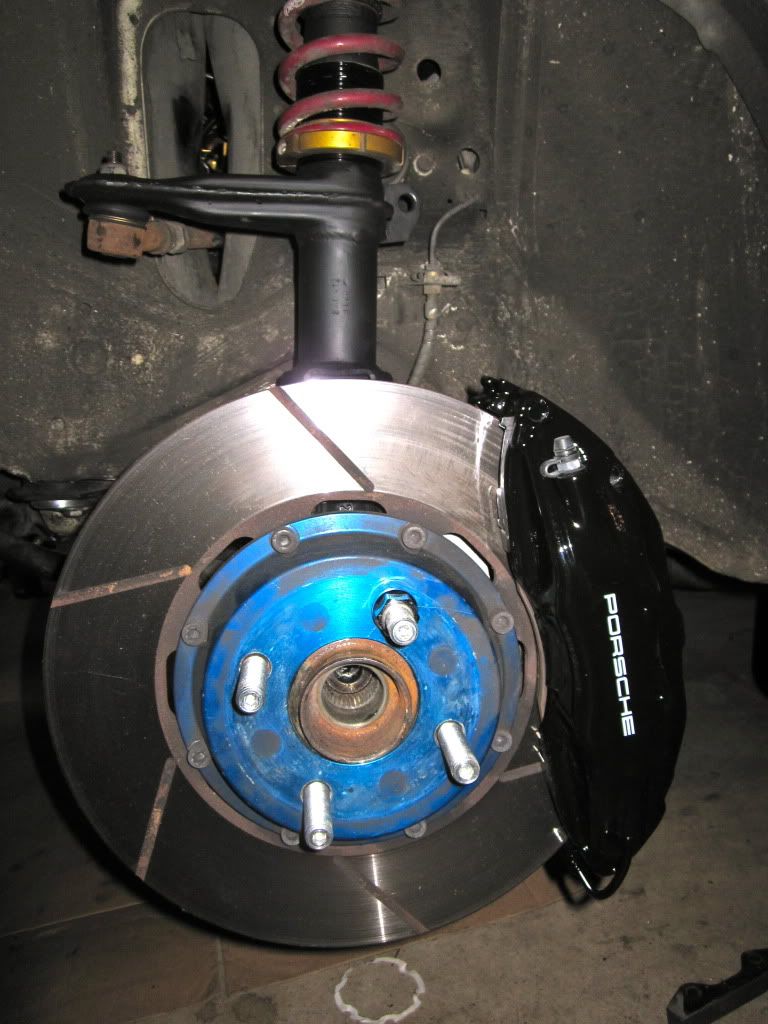

Brakes
- Porsche 928 GTS "Big Black" Calipers
- 13" 2-Piece Rotors
- Ferodo DS2500 Brake Pads Front and Rear (Street)
- Performance Friction PFC08 Pads Front (Track)
- SS Brake Lines
- Motul 660 Brake Fluid
- Tilton Adjustable Bias Valve

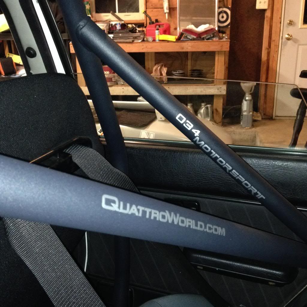

- Safety Devices Roll Bar powdercoated fine textured black

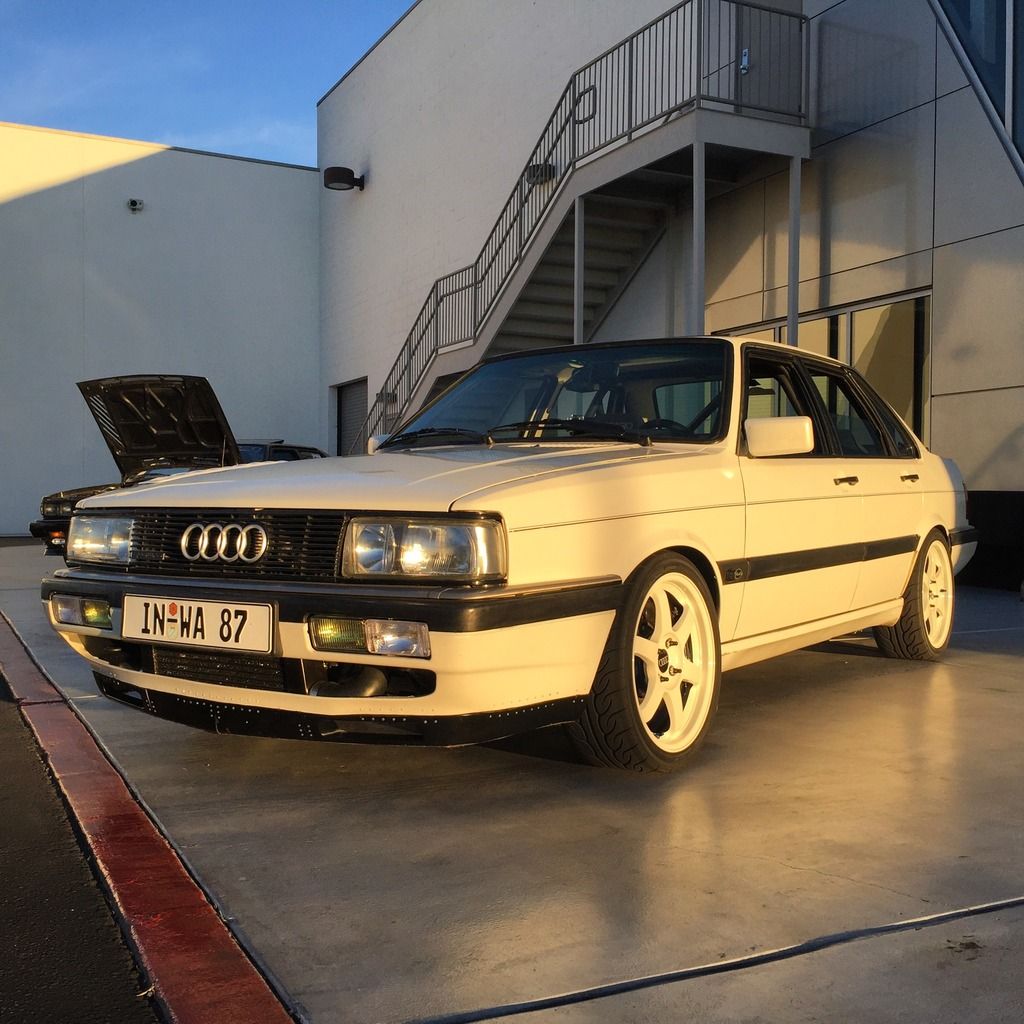

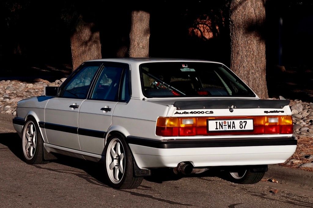

Exterior
- Modified Front 4kq Bumper with Lower V8 Valence by Derek Wanting
- 200 Front Mud Flaps Mounted Front and Rear
- Euro H1/H4 Headlights (Relayed Lows and Highs)
- Euro Rear Taillights
- Rolled Front and Rear Fenders
- Euro Bumper Rebar with Yellow Reflector Fog Lights and Clear Turn Signals.
- Pontiac GTX Hood Louver
- Porsche 944 Script Door Handles
- BlauSport Rear Spoiler Lip
